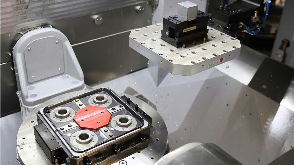

The Batch Process Manager is based on the pallet management function of the TNC 640—or, to be more precise, it interprets the pallet file in the background. All of the entries you make into the Batch Process Manager are stored in this pallet file by the TNC control.
The following process elements are available to you for entry:
  • Pallet
  • Fixture
  • Program
Modelling the actual situation
Based on these process elements, the Batch Process Manager models the actual situation of a machine with pallets. Each pallet is given its own entry, or, alternatively, you can define a fixture level and the appropriate NC program for the workpieces.
Easily change your entries at any time
The Batch Process Manager provides convenient editing options for entering the required data. You can copy, move, and paste individual or even entire process elements. It is also possible to add new entries during pallet management. You can thereby create a pallet list that will be executed in sequence. It is even possible to lock individual programs or even entire pallets, which will then be simply skipped over in the machining sequence.
